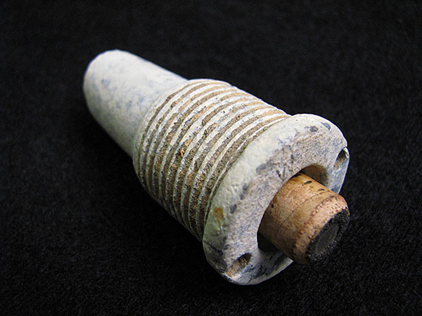

Being new to this forum, I'm a little late coming across this post. For some reason I can never see any images in Mr. Bartleson's posts that I have come across, so I don't know if he already included any examples above similar to what I show here.
Shown are two examples of fuse packages, each containing five 8-second fuses. The top is obviously from the Frankford Arsenal, the bottom maker is unknown. That package may or may not be Confederate (despite what many sellers will tell you, everything un-marked is not Confederate!). Many small Union suppliers did not splurge on packaging, and I have handled a large variety of fuse packages over the years.
A 20-second fuse is also shown in the photo.
This photo shows a paper fuse partially inserted in a Parrott Type C fuse adapter (the adapter is excavated), just as an example of how they were used. You can see a couple of the gradation lines on the fuse where it could be cut to a shorter time.
I don't know how much interest there is on this board in US Civil War ordnance. I have a fair amount of field projectiles and fuses/adapters that I've excavated over the years. Can post if there is any interest.
-Bruce
