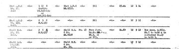

Found this on the internet about production of 6 pr ammunition
