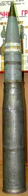

Basing my info on EOD documents, not perfect, but the best I have to go on. Two projectiles, a 130mm and a 122mm. Both have a typical Soviet ejection type base, with the off-set holes on the plate.
The 130mm appears to be an illumination, but it has two white bands rather than one, and the bands are above the bourrelet. Both counter to me information. The 122mm is painted entirely red, original paint. There is a slight remnant of the 122 from the painted markings, nothing else. The rotating band is also not typical, with light knurling at the top of the band. The only reference I have for the body to be entirely red is for the 82mm mortar as a propaganda projectile. My first thought was that it may be from a satellite country, but there appears to be some light stamps that may be Cyrillic.
Can anyone steer me straight on these two?

The 122 mm is a propaganda (leaflet) projectile. If the band on the 122 mm is copper alloy, it's a 3A1 (3А1) or 3A1D (3А1Д). If it's sintered iron-based, it's a 3A1Zh (3А1Ж) or a 3A1ZhD (3А1ЖД).
The 130 mm may be a 3S2 (3С2). If you rotate it around 180 degrees the projectile designation and other markings should be on the opposite side. The designation will be truncated to just S2 (С2) if it is a 3S2.

Double checking the image shows the marking 130-58, which suggests this is actually for the naval SM-2-1 (СМ-2-1) 130 mm 58-caibre gun.
The links below list a few of the projectiles for the SM-2-1 gun, though I have a few more details locally.
Again, rotating the 130 mm projectile to show its filling production markings (on the ogive area) and truncated designation (on cylindrical body area), should show the model. Well as long as the markings are still there. Even if the stencilled markings are missing, many markings are also embossed onto the body of the projectile. Like those visible on the forward driving band.
If the 130 mm projectile is naval, they generally have a screw-in base, but not always.
As to what it is... it may be a practice projectile, which would emulate the OF-42 high explosive and similar projectiles. I presume this would have the truncated naval designation of PS-42, or something similar.
An image of some 130 mm UPS-44 practice rounds (for other 130 mm naval guns), and their PS-44 practice projectiles is below. These show the double white band around the nose as seen on your projectile.
Eggburt1969, practice or drill with these 2 white bands ?

As there's a propellant charge (see case markings), it would be a practice and not a dummy (drill or loading) round. As far as I can tell the naval PS-xx series are practice projectiles, which have an inert filling and dummy fuze. The PS code is short for the Russian words for practice projectile.
First thing I checked. Unusual, but no traces of markings on the other side.
