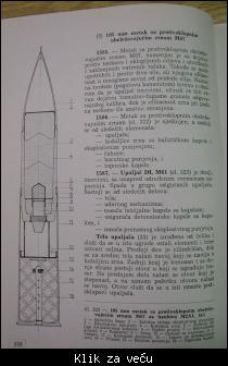

those cases are not for AP-T but for HESH-T rounds. there was no 105mm AP rounds for howitzers in yugoslav army.
cyrilic POZ means 'protivoklopno zrno' which is round based on hompkinson efect or high explosive squash head round. usual designation for AP round is 'pancirno'.
Dude, read this ;)
POZ (ПОЗ) - Противоклопно Обележавајуће Зрно
yup, you put drawing of HESH (protiv-oklopno) round, not AP (pancirno), from book Ammunition part 2. now, turn page 332 and see if there is AP (pancirno) round for 105mm hows on the list.
