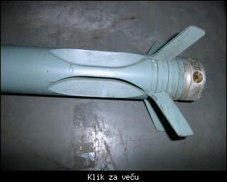

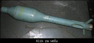

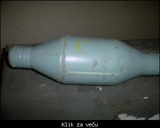

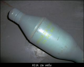

YugoM57Panzerfaust (1).jpgYugoM57Panzerfaust (2).jpgYugoM57Panzerfaust (3).jpgYugoM57Panzerfaust (4).jpgYugoM57Panzerfaust (5).jpgYugoM57Panzerfaust (6).jpgExxtremly hard to find.
I got it in Slowenia last week.
First time I have got as inert baby, regulr only practice.
Fuce is missing.Directly destroyed from factory which inert the ammo.YugoM57Panzerfaust (6).jpg

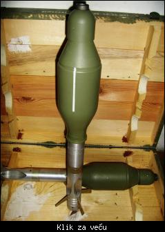

Thats very nice... All I have been able to find so far is a US military rubber training aid for mine... would love to fine a set in a crate like VuleM :bigsmile:

VuleM, but those are sub-cal training devices.
In my opinion the live version (inert) grenade is rarer. :)
In all the books about it, it is described as a hand mortar, also if we look at the first picture, you will see "barutno punjenje", a special tube made out of cardboard, filled with propellent, wich pushed the mine out of the barrel, there was no rocket filling or anything...just a shot.
Vule, yours are model 56 mines, used for training, nice set, also with cleaning rodes for cleaning the inside barrel of mines.
There were 3 types of mines used in JNA, live one (model 57), training (model 56) and an inert mine, used in school (olska), wich was in light blue color.
