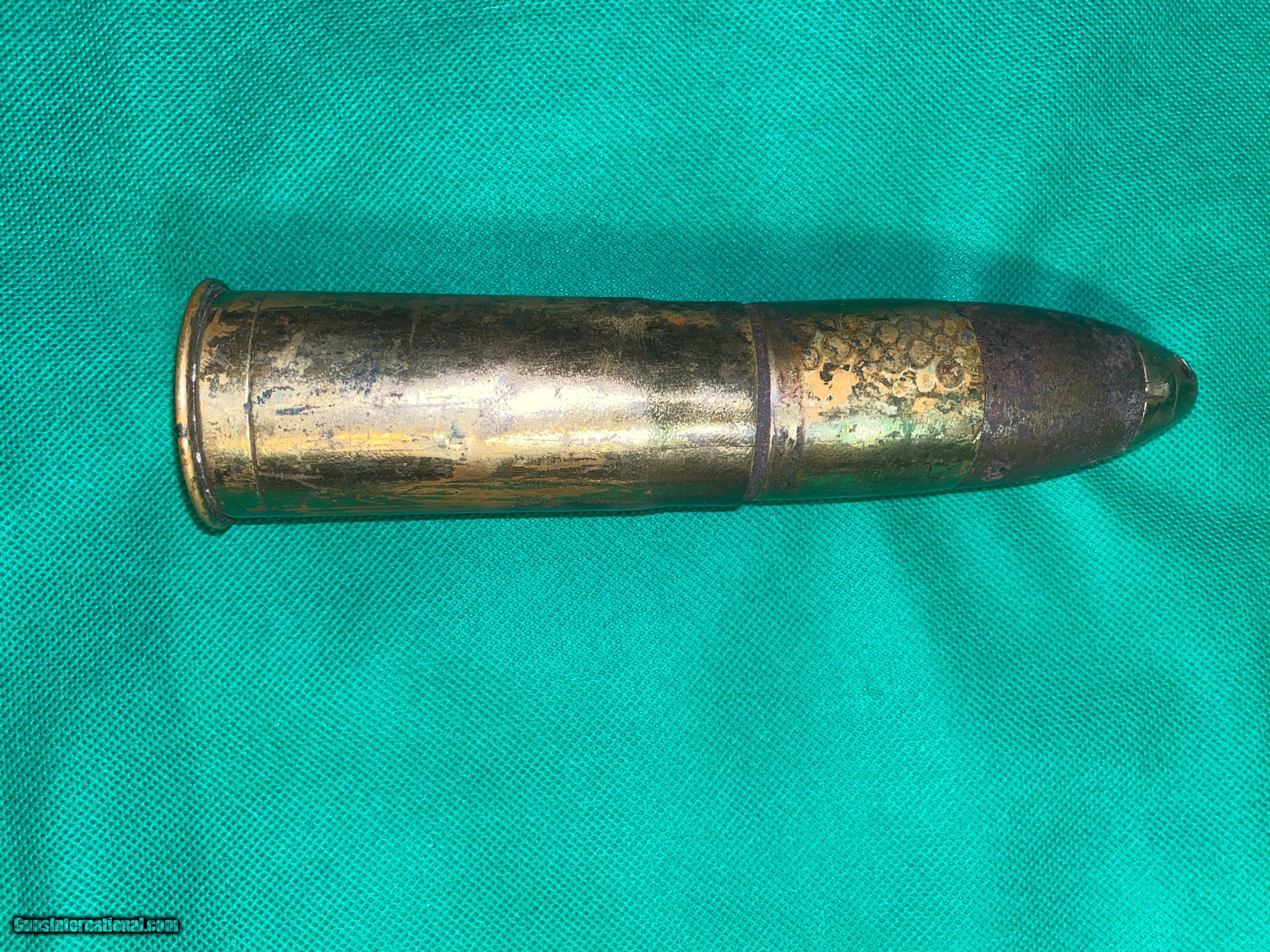

please help me with identifing this 3,7cm projectile. Its 13,7mm long and the diamter at the tip is +- 10mm with the only marking on the whole projectile.
The stamp is the Hotkiss-Logo:
I think it's "BBH" for: Benjamin Berkeley Hotchkiss
The shell is for calibre 37x208, see here: https://www.bocn.co.uk/threads/french-37mm-mle-1929.107992/.
I think it was made for export? According to https://quarryhs.co.uk/ammunition-data-table/ it was a anti-aircraft gun.
The shell is hollow and the base is screwed in. Notice the two key-holes.
