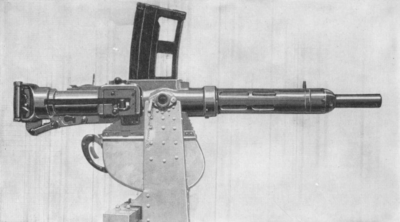

The GUN :

as I know italian 25mm vickers, fiat or 25/41 had specific tracer shell.
none AP was tracer.
in the pic:
25mm fiat , vickers, nordendfeldt
25mm shells fiat vickers was the same using different case
HE with special sensible fuze
APHE
training shell
concussion shell could it be tracer or incendiary.
25mm HE the 2 model issued
25mm canister
25mm CF = carica fumogena = smoke. smoke means tracer
this shell could be found with CI marking = carica incendiaria = incendiary
