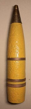

I am looking for a cutaway drawing of the shell and the fuze for this french 75mm WW2 anti-aircraft shell. I would alo like to know what shellcase goes with it (length).

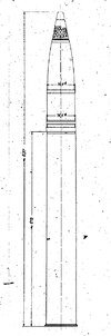

Projectile from :
L. Dv. 4403
Règlement provisoire de manoeuvre de l'artillerie de D.C.A. Première partie. Titres V et VII. 75mm Mle 30
Fuze from :
Ecole d'application d'artillerie. Organisation des matériels d'artillerie. Tome I. Munitions
Hope this helps.
Cheers,
S.

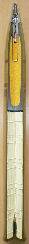

same round, different fuze.
