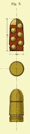

This German or Austrian 37 x 94R Canister round is either tinned or chromed? and came with these 3 pieces and 3 shrapnel balls that fit into the nose.
Projectile is 84.5mm (3,325") long without the base . Balls are 15.3mm (0.6") diameter.
The Berndorf case possibly may not be original to the projectile. What case would be correct for this canister projectile

I think it's a German Gruson/Krupp Kartätsche. Text says it carried 18 Lead balls with 15 mm diameter and three Lead-Antimon inserts. The Berndorf factory produced a lot of cases for Krupp so it can belong together because also 1895 fits well.
