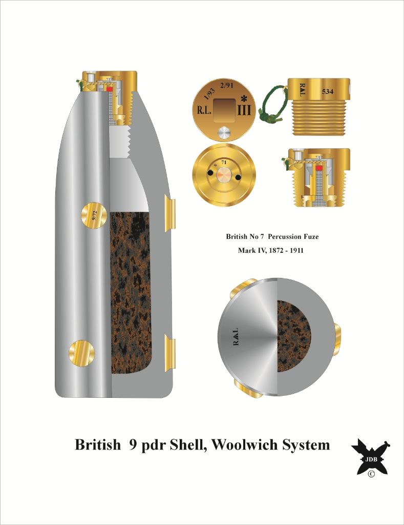

Attached is the British royal Laboratory No. 7 Percussion Fuze. Regards, John
# 7 fuze. Not very big, hence the small size of the box compared to others for small arm ammunition. I imagine standard for the 9 pdr. RML then, which was the main gun in use here at this time.
Yes the No. 7 was used in the RML 9 pdr copper studded Woolwhich system. Armstrong's EOC also manufactured it. I think I posted this once before. Cheers John
