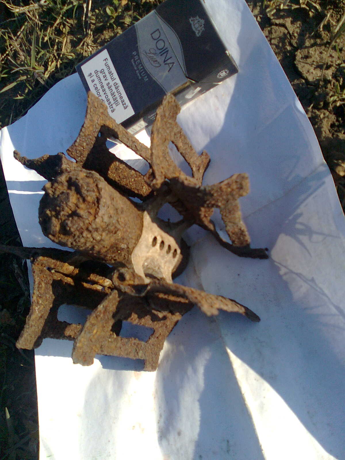

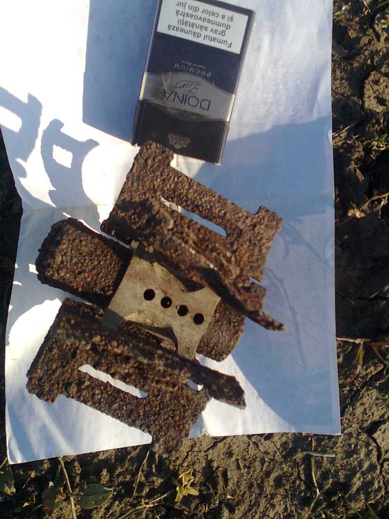

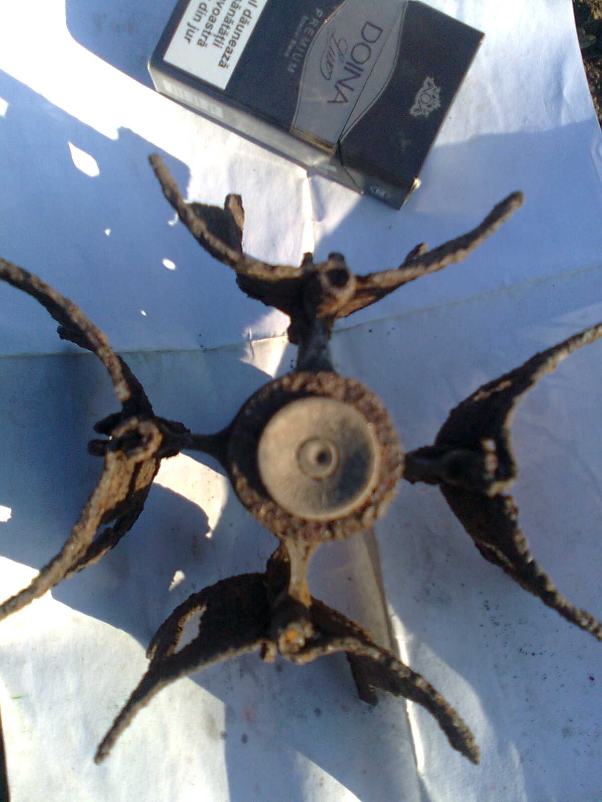

Italy had a tail like this on their long bodied 81mm mortar, the US developed one as well, I believe the US one was later. WWII timeframe for each, the Italian guys should have some good photos - if not some can be found without too much trouble
I'm sorry but this tail is similar to italian 81 mm G.C. tail, but in my opinion it is not the same ... What's about the headstamps of the propelling charge ?

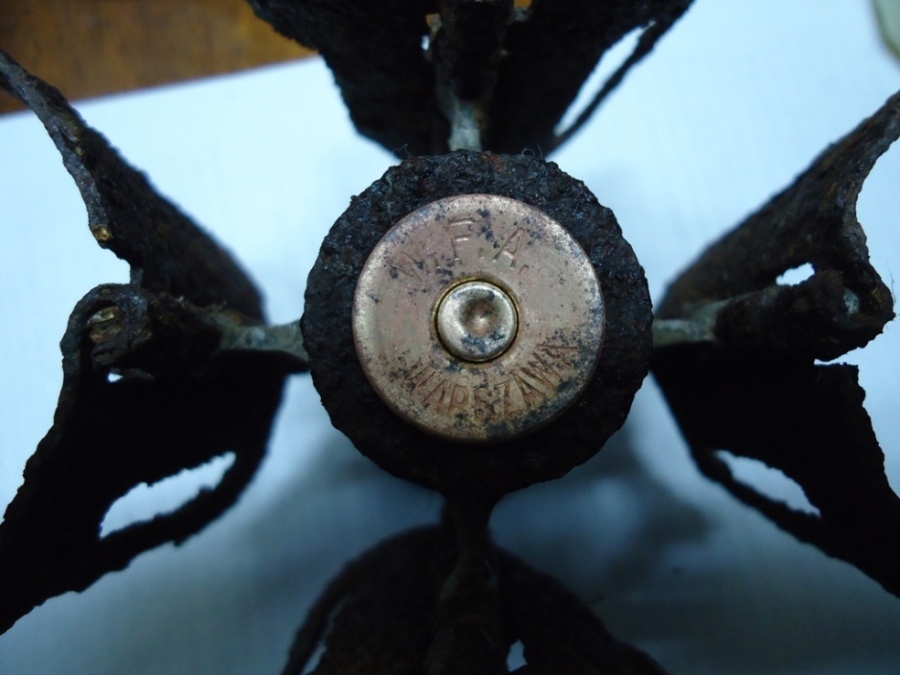

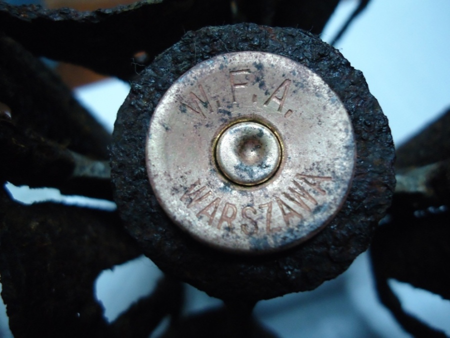

I have 81мм a mine, but that that on a photo is made another. Searched on the Internet, but the information hasn't found. The question remains opened
I was thinking that they might be the folding tail fins from a US M45 81 MM mortar
Here it already is very interesting. And you don't have separately the drawing, the tail? The inscription on the case VARSHAVA, who the manufacturer interests?

If you look at the leading edge of the fins, they are perpendicular to the tail boom, making them most likely from the U.S. M45 81mm mortar projectile.
If the fins were slanted back on the leading edge, it would be from the French or italian mortar projectile.
You could also confirm identity by the headstamp of the mortar cartridge in the tail.

The friend has sent me a photo of the cartridge, now isn't clear that did the Polish cartridge in the American mine. And he has still made a name spelling error
attachment.php
attachment.php
Warszawa is Warsaw in Poland and PFA was their state ammunition factory and they also used this folding fin design which is a Brandt development. Their designation for this shell was "wz31" (M31).
