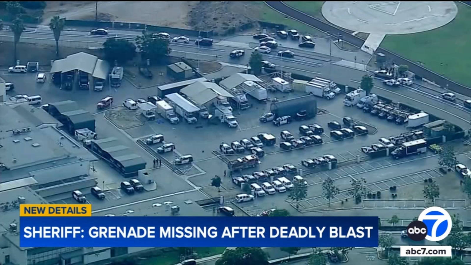

3 deputies killed thought grenades were inert before cutting one in half
unfortunatley they have made some horrible mistakes which cost them their lives.
mis identified item,
cutting it open in the parking lot?with what? a grinder/hacksaw?
all 3 of them had to be standing right next to the guy doing the cutting to have been killed
why were regular deputies doing EOD work?the must have been trained in this type of work
Obviously not checked before cutting. I thought these days they would identify or if not sure, in doubt just blow it in a safe position. Not hack or bash it etc. Seems these poor guys needed more training.
From another report posted on youtube.
The explosives that detonated and killed three L.A. County Sheriff’s Department deputies may have been found in a storage unit at an apartment complex in Santa Monica, a law enforcement source tells KTLA. The source then reported that the deputies initially rendered the explosives, military-style grenades, inert before they cut one open the next day as part of a training exercise.KTLA 5's Eric Spillman reports. (July 21, 2025)
