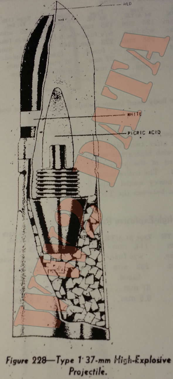

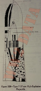

Yep! Japanese. Thanks for the lead.
(Compliments of WW2 Equipment Data webpage)
Type 1 37mm High Explosive Projectile
This round is used in the Type 94 Anti-tank gun and the Type 1 Anti-tank gun.
Overall length of projectile: 104mm (no fuze) for all types
Length of complete round, fuzed: (94AT) 250mm (1AT) 333mm
Diameter at bourelet: 37mm for all types
Width of rotating band: 11mm for all types
Weight of projectile: 1 lb 6 oz without explosive
Filling: Picric Acid
Used in: Type 1 Tank Gun, Type 1 Anti-tank Gun, Type 94 Anti-tank Gun
Color and Markings: Black body, red nose tip, white body band.
Remarks:
This projectile is constructed of high grade steel. It has no sharply defined bourrelet. It uses a small Mk 1 base fuze which also acts as a base plug.
