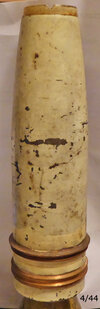

Hi....enclosed, the 6pr R&D AA HE.....

I would not call that a Probert projectile.. I see the high gas check band, but this does not make it a Probert.
A proper Probert projectile has an additional driving band at the bourrelet as I understand it. The barrel should also have a long leed and a bore constriction to swage down the bands.
I have the identical design in a post war 3" naval type with the upper band which is really a centering band and these were squeezed.
I think these 6pr don't have that due to size only, but I think the point of them was the extra velocity and I think these very long barrels
are for that purpose. Some one else I'm sure can weigh in on ths. But i've also heard of a 3.7 version which was very effective.
