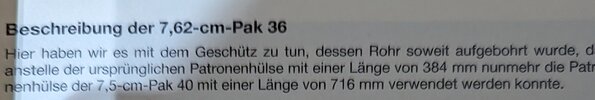

Thank you very much Ladislav, but i already know all this. If you read my question, il is only on the cartridge (case length , case dimension on the rim , headstamp...).
Only the differences between the pak 40 cartridge and the Pak 36 cartridge. )We all know that the shell are different in caliber and at the driving bands)
The 7,5cm Pak 40 and the 7,62cm Pak 36 used the same case and therefore to identify the 7,62cm shells the projectile had the white tip or white ring.
The WR 84 states the 7.5cm Pak 40 case of 716mm could be used.
PC

Thank you
I have seen some informations here about the charge and case length
