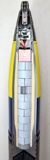

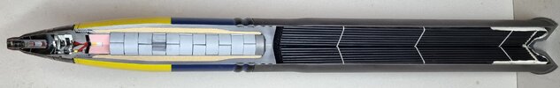

At first -due to lack of info and the top part missing- I misinterped it as an 8,8cm M-shell. Later I understood it was a Brandsprenggranate -obtaining the incendiary pellets-, but still missing the top part. I finally got the top part, but it took me some years to finally refinish the cutaway model (I hate doing a job twice). So today I fanally finished the third type of Brandsprenggranate. Where the first two types have a central exploder in a cartboard tube with rings or loose incendiary segments around them, this type has a central cartboard tube with incendiary pellets with explosives placed around it. As with most German shells the booster is Pentrite (pink), I make the educated guess it was the same in this case.
The projectile is stamped march 1945, so I assume it was too late to be taken into large scale production.

Piotrs Picture gave me much info, as it is now clear to me how the stack of incendiary pellets were placed in the shell; a cartboard tube containing the pellet, most probably glued in the explosive charge by means of magnesiumkit.
If anybody has any more info, please let me know.
