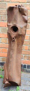

As a new member of this board I thought I’d start by sharing some pictures of a container I’ve recently acquired.
This AB 23 container, was pretty corroded, distorted and dented. It was also missing the interior partitions that had rusted off and disappeared long ago.
Someone had previously attempted to bang out large dents with a small hammer, resulting in lots of small dents.
It was quickly apparent that this was never going to be suitable as a ‘concours’ restoration, but I have had a go at ‘tarting it up’ to a state where it is good enough to display.
First, I gave it a bath of Evaporust and then a coating of thick red oxide inside and out.
Spent some time in the garage sorting some of the dents and deep pits.
