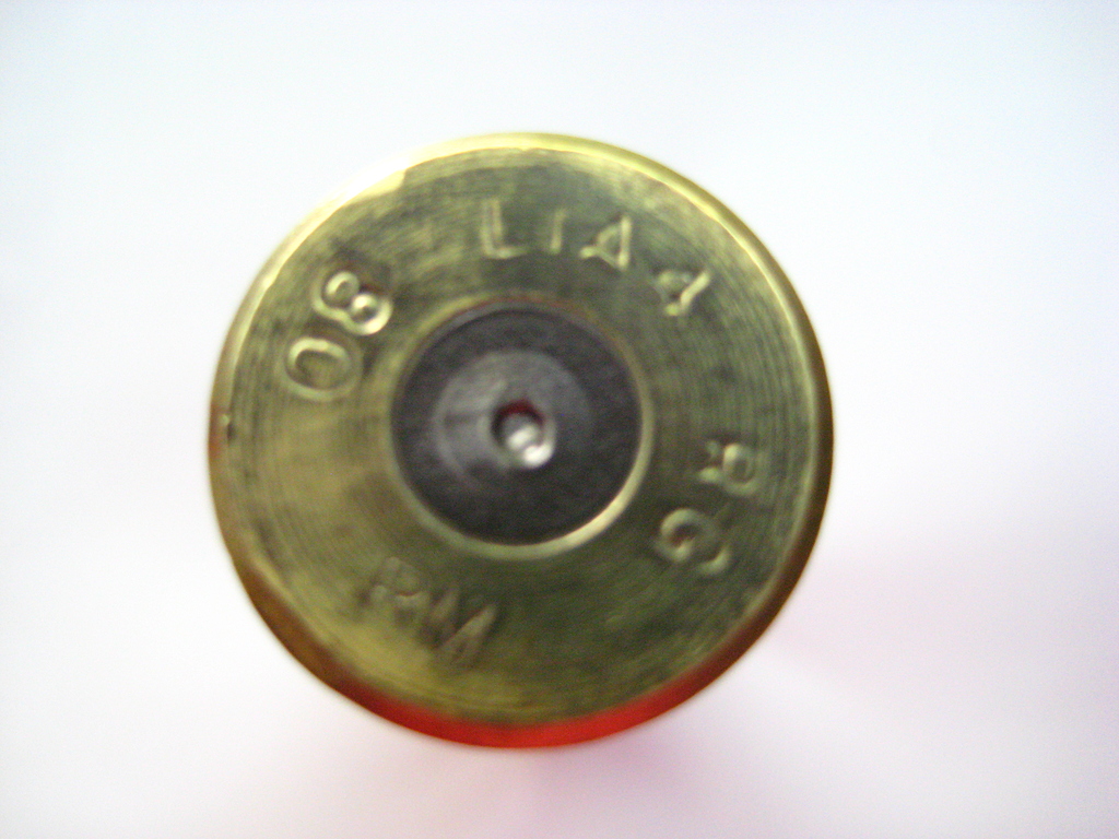

Anyone help me out with this case?
SteveM
Heavy base to me would say something powered eg Apache cannon? Looks about 20mm
Looks like an RG ( Radway Green) and L3A1?
Just in case you don't want to wade through the entire IAA (International Ammunition Association) Forum post string, your item is, in UK military parlance, a 'Tube Vent Electric .625 In. L3A1'.
A Tube Vent Electric (TVE) is an electrically-fired igniter cartridge for rounds fired by the L11-series of 120 mm tank guns. It is used with propellant charges contained within a combustible bag, or contained within a combustible cartridge case.
I presume the production codes mean it was produced by Radway Green (RG) in 1986 (86), the lot (batch) 276.
Adding a little more info here, the L1 and L3 series of Tubes Vent Electric (TVE) .625 Inch used for the 120 mm L11 tank gun were superseded by the L4 TVE for the L30 120 mm tank gun. The L4A1 TVE was introduced in 1990 when L30 guns were retrofitted to Challenger main battle tanks (MBTs), just in time for the Gulf War. The L1 and L3 TVEs were a one piece brass body. The L4A1 TVE had a two piece body: brass in the forward portion and Berylium in the rear portion. Berylium is better able to withstand the greater chamber pressures experienced with the propellants used in the L30 gun. Berylium Oxide is classed as toxic but Berylium / Copper was stated to have no toxicity hazard. As a precaution you should wash your hands after handling an L4 series TVE. The L4A1 is not interchangeable with the L3 TVE in the L11 gun. The L4A1 TVE and L30 Gun combination were, in 1990, approved for use with:
