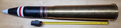

Comet 77mm
An early example of a 77mm cartridge as used on the Comet tank.......I believe.
77 x 440R.
Nice Vickers Armstrong stampings, no primer though.
77 x 440R.
Correct - the Comet was the only user of the 77mm AFAIK, the gun was only devised because the 17 pdr (which used the same projectiles, including the APDS) was too big to fit in the turret. The 77mm cartridge case was based on the WW1-era 3 inch 20 cwt AA gun's, but was loaded to a significantly highly pressure.
Hello Tony
what is the length of the comet case please ? 440 mm like here or 420mm like here
regards
The shellcase is 420mm long.

Yes it is 420mm case length. All these 77mm cases seem hard to find.
I only have VAEL 1944 LOT 155 CR
ECC 1948 LOT 46 cut and overstamped as a MK 10 A/S MORTAR which is a shame.
Also I note MK 1 cases:
VAEL 1944 LOT 96 CR
RLB 1944 LOT 133 CR
If the 77mm was a hotter load than the 3" 20 CWT are all the CR loads weaker for Practice firing?.
Hi thank you ron3350 and pzgr40 for your informations
Then 440 mm as said cestrialad was a mistake .
This comet case is difficult to find. I have Never found.
Regards.
I was very lucky, a collector placed it on the Dutch collectors forum " Brittish shellcase for sale, 30 euro's". I was as lucky to be the first one to react.
