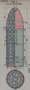

I am looking for a picture of a good condition German 1st WW 7,7 cm Kartätsche as seen on the attached picture. Basically I want to know if the steel sheet metal was tinplate?

Ahh thanks, already knew this drawing but had no idea to look at it.
Fig. 6 says "Mantel aus Weißblech" which means "body made from tinplate" so my assumption was right.
