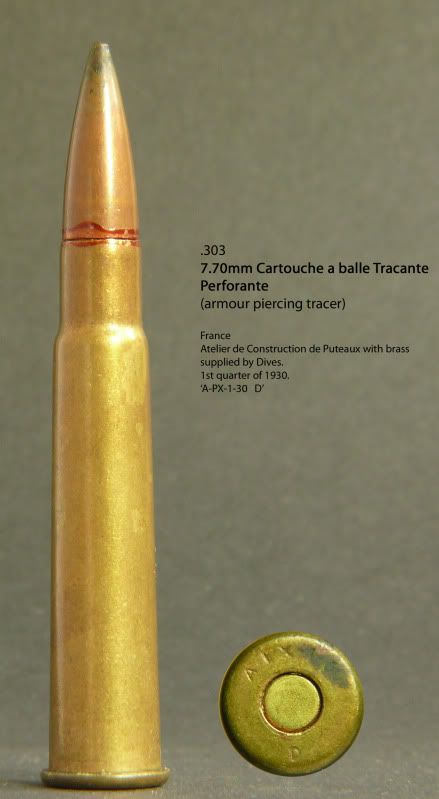

Your bullet type is a bit tricky; I've got several French .303's but I don't have one which is specifically armour piercing however I have got an 'armour piercing tracer'.
French .303 types were identified by primer & casemouth seal colours so it would be a big help if you could detail any seal colouring on your round. For info my armour piercing tracer round has no primer seal and a red casemouth seal.

Armour Piercing Tracer, GM bullet, bright red cms, no p.a.

Obviously the headstamp is different but my guess is that you've got one of these, an Armour Piercing Tracer.
