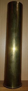

Hello again! It's been a while since I got anything... well I only go to one fair a year and it's not very big... I found this in an antique shop, any ideas?
The brass piece did not have a "little bird" like the one in the image... the measurements are 75x385, but on the website where I usually see I can't find anything, the only one is 76.2x385 R but inca that it is Russian and in another it tells me By measurements it could be French, could it be reused material?

The brass case is a nice German 7,5 cm Flak14 typically found in Spain. I would weigh the "aluminum" case and compare with the weight of a brass case. I am pretty sure you will find it is coated and not made of aluminum.

Hello Hoeksel, thanks for the information! I did not know the Flak 14 (I have a lot to learn) regarding the aluminum piece, I can confirm that if it is aluminum, as soon as you pick it up you can see that it is very light, out of curiosity I will tell you, it weighs 391g

Hoeksel: I found it curious, I don't have any aluminum ones, except for a modern 30mm or 37mm I don't remember now (just the case) and an empty German lighting cartridge from WWII. Regarding the flak 14, from what I looked at a while ago, it is a descendant of the FK 16na, but the ammunition is not the same or so I think, in caliber but not in length. Is there a photo of complete ammunition?

For the first case (brass) , Flak 14 : it's a 76,2 x 385 or a 75 x 385 ? who has some pictures of the shell ?
