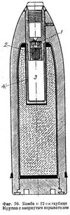

I don`t have drawings or measurements with the shells you are asking about, but i can tell you that the fuze in the left shell is a typical Krupp export fuze.
The same fuze was used by ammunition for the Romanian model 1901 Krupp field howitzer.

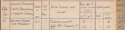

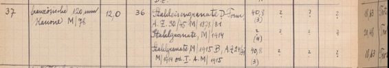

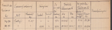

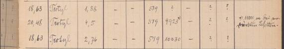

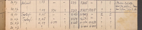

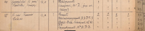

A German manuscript dated 1917, Berlin (the drawings in the first post are from it), also lists
:- 12cm Japanese howitzer (Krupp)
Steel shell: 20.07 kg; 1.33 kg Melinite; Muzzle velocity (Vo): 273 m/s
Shrapnel shell: 20.07 kg
I believe that the Japanese and Russian shells supplied by Krupp for this 1905-model gun are identical.
- 12cm Cannon L/50 (Obuchov)
Steel high-explosive shell: 20.98 kg; 2.05 kg Tritol; Muzzle velocity (Vo): 930 m/s ; Length of the projectile without the fuze: 520 mm.
Steel shrapnel shell: 20.98 kg ; Length of the projectile without the fuze: 227 mm.
Cu band width: 20 mm.
The 120mm obuchov is actually a naval Vickers canon , but good guess , il check on it.
That is precisely (apparently) different material, because in the manuscript it is a separate entry in the table:The 12cm Vickers gun has different figures compared to the 12cm Obukhov: compare...
