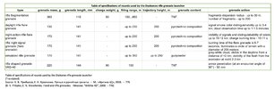

From what information I have gathered re the Dyakonov grenade, there were 5 types of round.
1. Rifle fragmentation grenade
2. Daylight rifle flare grenade
3. Night-action rifle flare grenade
4. Rifle night signal grenade (flare grenade)
5. Simulated rifle grenade.

See included table and associated reference attched:

Thanks for your reply.
Since that time I learned the grenade without external frag is also HE
Thanks for that information. It must have something to do with the colour markings, which I have not found.
