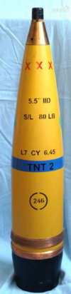

Hi all,
I'm currently 3D modelling a replica of the BL 5.5 Inch Howitzer shell, and coming up against the proverbial brick wall when trying to find reference images, technical drawings etc. How the driving bands look and their relative size especially. Hoping someone may be able to help :)

Actually your Driving Bands for this 80lb Mk2 should be as per this drawing. You can extralolate the outside dimensions fro5.5he80lbMk2DrivingBands.jpgm those shown
So i'd leave your rear DB as is. and just modify your design for future prints.
Forgot to update the thread, but thank to your assistance, this is what I was able to produce
