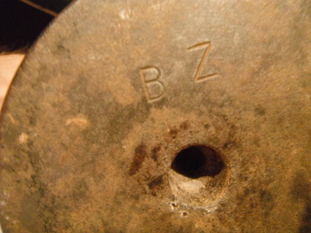

US 90mm T33 AP-T shot (?)
Rafail
SHOT, FIXED, A.P.-T., 90mm, T33.
DESCRIPTION. The 90mm Armor Piercing Shot T33 is issued as a fixed complete round for the Gun, 90mm, M3 mounted in Heavy Tank, T26E3 and Gun Motor Carriages, M36 and M36B1. The shot is a modification of the standard AP, M77 which has been reheat-treated and to which a ballistic windshield has been attached.
it has 4 small places on the top where the windshield was attached.
Only signs on the body is a stamped M on the bottom and an N on the side.
Any thoughts or comments please?
the more i search i am more certain i have a T33 tank APT shot... but is it possible to date it with only 2 letters stamped on it ?
also does anyone has a photo of a complete one ?

The markings are Yugoslav (not Russian) where plenty of US ammunition was used.
It was originally an M77 AP - not a T33E7. If it has indications it had a windscreen attached it must be an early version probably just a T33 (no E number). THe M77 had a larger bourolet and it was lower and the M77 also had a smaller tracer element as does yours. In my Pic is T33E7 on left and M77 on right.
