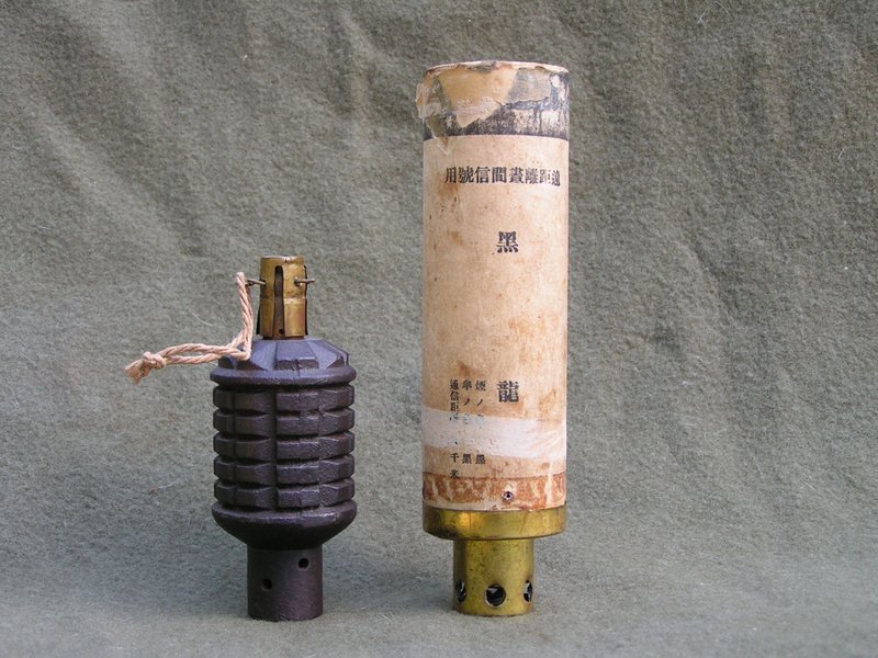

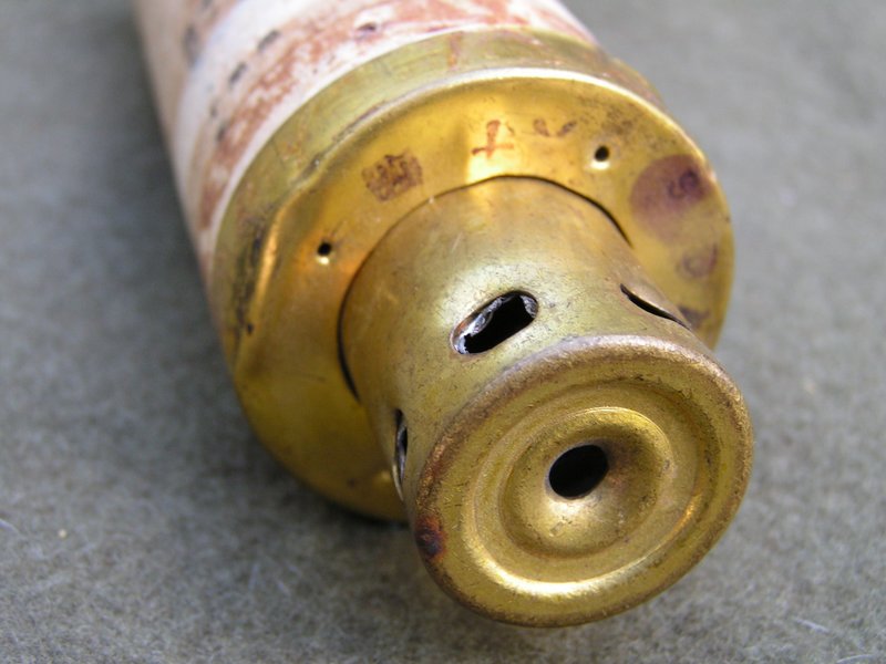

Colin,
You mentioned a brass booster cover needing identification. By chance, did it come from an ordnance source in China who used to sell on eBay? If so, I recall seeing that piece on eBay or Gunbroker. I'm pretty sure it's the propellant container for the 10th year flare and smoke rounds fired from Type 10 discharger. Look familiar?
This one is a daytime black smoke round. The body is made from a cardboard tube so the survival rate is a bit low on these.
Nice item, I have never seen one of these before, cardboard looks in very good condition. Tony.
Great info and photos
Hi, Thanks for the great information and photo's. The cap looks very similar, it's good to have it identified. Cheers
