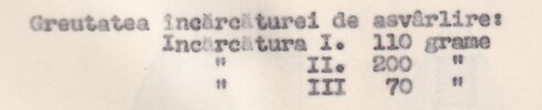

This one uses a necked down metallic cartridge with double rim of unknown dimensions. We have pictures from the Bucharest Military Museum of the ammunition this piece used and, knowing the dimensions of the shell, I was able to estimate them from the photos to around these:
