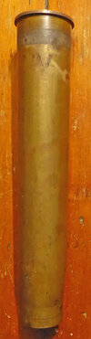

I picked up this typical common 6pr 7cwt case this weekend.
I didn't pay much attention to it until this evening. The headstamp is the usual
but I have never come across the stenciled black band around the base and the letters HV in two places.
I presume this means High Velocity, so a non standard load ? or for the Disgarding Sabot projectile ?
The base was thick with green and plaster bits oddly -

There were two different charges for the standard 6.291 lb AP projectile.
The original charge gave a MV of ~2650 ft/sec when fired out of the 43 caliber barrel, while the HV load gave a MV of ~2800 ft/sec.
The original charge gave a MV of ~2800 ft/sec when fired out of the 50 caliber barrel, while the HV load gave a MV of ~2950 ft/sec.
Thanks for that I had no idea ! Here is another one, more complete.

Nice cases. I had not seen an actual HV marked case before, only illustrations
Oops! :rolleyes: Just noticed I made a typo in my post above. The standard 6pdr 7cwt AP projectile weighed 6.281 lbs (not 6.291 lbs).
Sigh, I am going to have to start wearing reading glasses in the future. :(
Nice case. If it was for the discarding sabot projectile the crimping groove would be right at the top of the case, just a few mm from the mouth of the case. If the crimping groove is further down the neck of the case then its for one of the other loadings.
Dave.
Do you know when the HV load was introduced into service?
I cannot say for sure when the HV charge entered service, but Ammunition Bulletin No.32 (dated Mar'43) lists both the normal charge and the HV charge in the then current Statement of Ammunition for the 6pdr 7cwt.
I have read that the HV charge (initially intended for use with the 43 caliber gun) entered service in the second half of 1942, but this info is from secondary sources.
