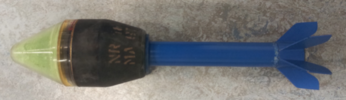

The Dutch HEAT rifle grenade was the NR 4 with nose fuze NR 37. The sight was the NR 17 and was used when fired with the FAL Rifle. The first marking was green with a red band and yellow text. The newer marking was green with yellow text. The practice with the chalk head was the NR 28. There was also a full metal practice version, blue with white markings. The pictures with the rifles are from the Dutch Institute for military history (NIMH).

The Dutch practice all metal version was the NR 5

It must be a Slip of the pen but the practice version with the chalk head is the NR 18.
