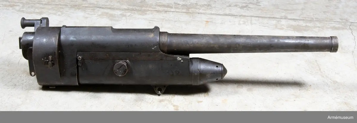

Dimensions 37 mm Skoda infantry support gun
Hoeksel

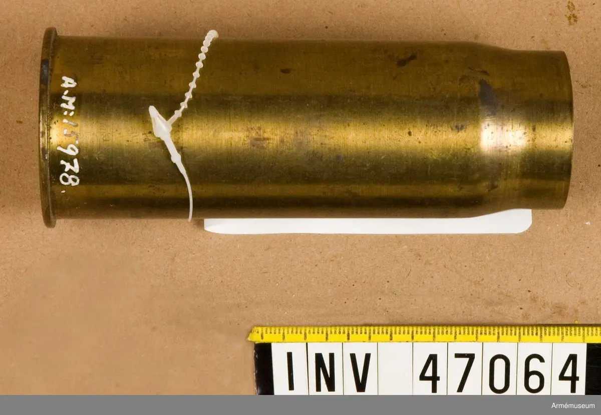

Does anybody know the dimensions of the shell case? Is it 103 mm long?

The case length is probably measured incorrectly...
No source for the length, I do have an 37x103R in my references but no image. I read about 37 mm Skoda a lot but still no proof of shell case dimensions.

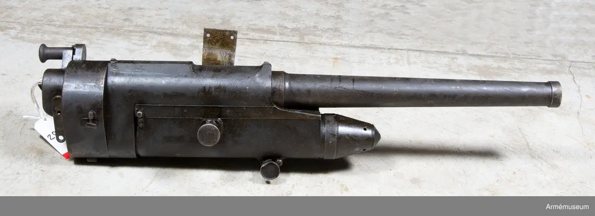

Skoda did not produce a single 37mm cannon, that's for sure.
So I'm wondering where you got that photo from.
Of course, a museum...can you give a link to that photo?

Hi Hoeksel
..Yes, d/27 is the expression of the barrel length in multiples of the caliber, I already wrote that it was the year 1921 of the production of those guns according to the museum data.

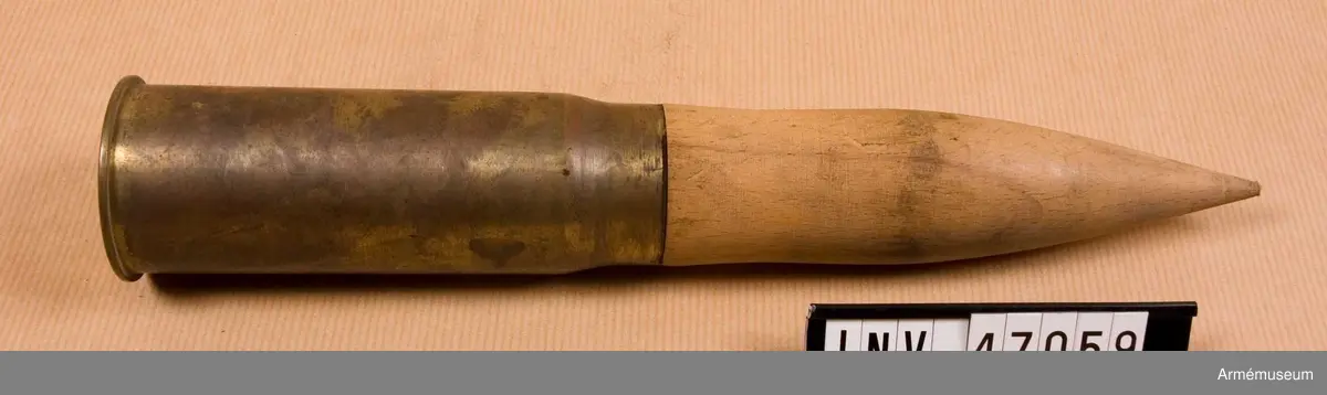

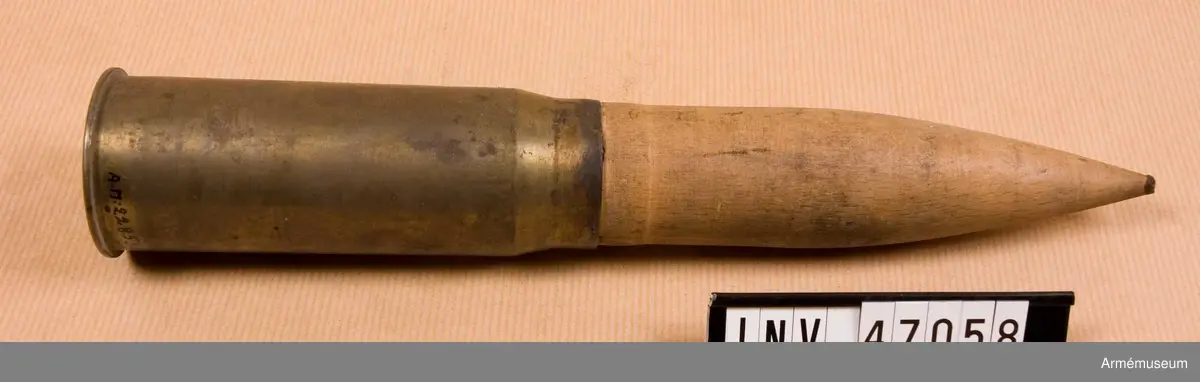

25 years ago I definitely had a description of that ammunition of about 6 to 10 sheets and within that a drawing of the cartridge assembly.
But suspicious operations and confusion on the disk and the disappearance of files I already buried those documents and switched completely to Linux ....
I vaguely remember that it had a rather atypical front ogival, i.e. like those wooden dummies,
that's why I wrote to you that it was for the same gun and the shape matches.

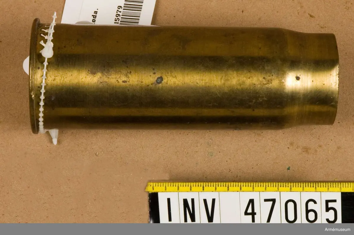

I doubt if the 37x101R43,5 and the drawing are the same shell case to be honest as the one from Sweden I show. The standard 37x94R has a rim diameter of 44 mm and if you look at the neck of the shown 37 mm Skoda I would expect the rim diameter to be > 44 mm. Also the neck on the drawing looks different then the one of the shell case.
I think we have 2 types of 37 mm Skoda shell cases, a 37x101R43,5 (unknown to me, great find) but I think the Swedish one is different.

Completely agree that it is not identical cartridges Sweden and the drawing.
True, true, there is a significant difference.
In the drawing, the neck is 2 mm smaller in diameter than the cartridge. On the cartridge sample, it is significantly larger.
