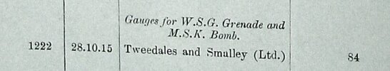

Unusual bit of kit. This is marked "GAUGE FOR M.S.K BOMB TYPE Q, SPHERICAL. DESIGN T W 222 T&S 10/15"
It dates from the early part of the War when much work was done on chemical natures. The Type Q Spherical was made of cast iron, filled with MSK a rather persistent agent, and the grenade was primarily designed for use in catapults and spring guns and the like. It was discontinued, but reappeared in late 1916 as Grenade, No 28 Mk 1. Spring guns were withdrawn from service in March 1917, probably much to the relief of those who had to operated them.
Alan1
Thanks for showing that - an interesting survivor, it is the gauge for the burster sleeve of the Type Q (TW222 design drawing) bomb. It was made by Tweedales and Smalley as one of 84 gauges ordered in October 1915 for West Spring Gun and Type Q bombs.
A detail regarding the Type Q bomb filling, the initial charging was a lachrimatory agent, code SK *, a mixture of 80% ethyl iodoacetate and 20% ethyl alcohol. Later, pure ethyl iodoacetate was adopted (code KSK), but there was no such filling as MSK. It was a generic term for the grenades with their various fillings, which included KJ (stannic chloride) and CG (phosgene).
* SK denoting Imperial College in South Kensington.

I thank Snufkin for his clarification, CW natures are a bit complicated, Landers gives more detail - probably provided in whole or in part by Norman.
