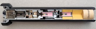

That was clear to me that it was a hypothetical question, as bombs found these days with a ELAZ 17 are completely corroded, and the only way to remove the ring from the fuze well is with a hammer and chissel, which is also suicide with a delicate clockwork inside that may hang on a spec of dust. With the cutaway I made from a ELAZ 17 with a ZUS 40 in the fuze pocket I used an empty fuze pocket with the ring still in place and I could only remove the ring with a hammer and chissel after cutting a quarter out of the fuze pocket and heating the top of the fuze pocket and using lots of WD 40. The aluminium of the fuze will be bloated, especialy if the ground found in is alkaline, you would not even be able to read any texts on the fuze head any more desciding what fuze it is exactly.
