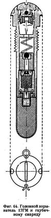

Fuze would have been 3ГТ ("3GT", where the "G" stands for "голова", "head" and the "T" for "TNT/Trotyl"), 13ГM (the "M" stands for "Melinite" - also, I couldn't find an exact drawing of it, but here's one for the extremely similar 17GM - I believe the only difference is in the booster) and the model 1884 percussion fuze with separate booster.
