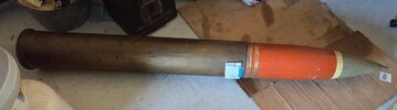

Never saw anything like this in the wild so to speak...
I am guessing about 17cm projo?
Guy wanted $500usd but he would probably go to 200. He says he has a mint projo that fits it too.

It was a sidewalk sale so measurement opportunities were limited. Case length maybe 4 feet. Doesn't the head stamp nail it?
Looks like a German WW1 naval case, the numbers on the base would id it. Can you get a proper pic? Some very knowledgeable members on here. I would think 200 dollars US would be a steal! The projectile wouldn't be common either.

Looking at the basepic using my editing tools I see:
3/Juni 1918/Magdeburg/Sp4C6

Whoops! Missed the maker
3/POLTI/Juni 1918/Magdeburg/Sp4C6

Got these today. Projo diameter is 175mm. Gentleman states it is not original to casing but "it fits".
Length overall is 5'8" (!)
He wants $600 USD for the whole thing.
If it was a casing for naval use the month would be in roman numerals
The case is a WWI German naval 170mm case. There are a couple of threads here about them. Quite a few came to the US after the war for some reason. $200 is a good price. Most seem be offered at $400. Projectiles are harder to find. It was separately loaded, so the projectile and case are not the exact same size.
I'd have thought $600 is a good buy for the whole thing, just my opinion though. Depends on how much you want it I suppose.
Dave.
As said before, the case is a 170x1050 mm originaly for the german Navy but here it is intended for the Army. The acceptance mark is Sp 406 and not a M with a crown, the month is with letters and not roman numerals as said by Luuk9319. The two manufacturers POLTE MAGDEBURG and PATRONENFABRIK KARLSRUHE made this type of case for the Navy and in 1918 only for the Army.
