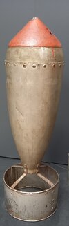

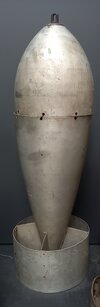

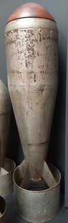

I recently visited Vytautas the Great War Museum in Kaunas, Lithuania on display were a series of bombs labeled as '1930's' but no other description. Pictures below.
Very nice collection. Oranovsky bombs except the all white metal one.
Oranovsky bombs were in continuous use in Russia/ Lithuania/ Soviet Union from 1914 to 1930s.
The white metal one is puzzling. I cannot definitively identify it.
It has a pure tear drop shape with rivet lines at mid body and therefore not an Oranovsky.
It looks very much like the SMM for naval aviation use (known only from drawings), developped after ww1 by the Soviet RKKA service - this would put the period of these bombs at 1924-27 and these bombs therefore as Soviet, not Lithuanian - the source of Lithunaian bombs were stocks captured in 1919-20.
Another possibility is that we are in front of another undocumented bomb of ww1 period - which is quite possible with Russian bombs, as so many experimental models were produced in small series for operational testing,
Or a Lithuanian indigeneous model of the 1920-30s
This puzzling bomb is not an Oranovsky but by looking through my files I found this photograph of a very simialr bomb being suspended under a Nieuport of the Imperial Russian Air Service during ww1. Same general shape, and central body position of the line of rivets. Only difference, the shape of the fins connecting the bomb to the stabilizer ring, but this is probably due to the fact tha the bomb in the photograph is a heavier one (heavier ones had more extensive fins). So, a ww1 bomb.
