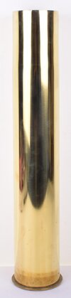

Looking for images and dimensions for 10,5 cm Karlsruhe made cases with Krupp numbers 164 and 915
Hoeksel
In my streak of asking hard questions, who can show examples? I want to verify if they are the same shell case or if they differ. Length should be around 650 mm with a rim diameter of 129 mm.

It is a 105 mm FLAK case prototype for the 105 mm Krupp Kraftwagen FLAK guns introducaed in service in 1917.
During my researches about WW1 german FLAK artillery , I have discovered that the cartridges cases for 8,8 cm and 10,5 cm were coming out of the german artillery of the KiegsMarine but had been shortened slightly for the purpose to put a second driving band behind the first one which is narrowed ; the fact is that the chamber of the guns for the Flak is exactly the same that for Marine guns.
In fact the shells devoted to Flak can be fired in Marine guns as well as Marine cartridges can be fired in Flak guns !
The result is that the Flak cases are about 10 mm shorter than the Marine but all others sizes are exactly the same...

I had a look to my FLAK cases collection and I have found this about Flak cases number :
3,7 cm Sockel Flak N° 917
76,2 cm Flak N°916
8 cm Flak N°913
8,8 cm Flak N° 914
10,5 cm Flak N°915
So it seems that the Flak cases were developed in a single range during 1916.

Hi Ckoala, you gave me an interesting insight of the number "9" being "Flak war time". In my latest updated article I have the following Flak guns from WW1:
904 = 7,6 cm Schneider-Canet L/45 M1912 Flak
913 = 8 cm Krupp L/45 M1916 Flak
914 = 8,8 cm Krupp L/45 M1916 Flak
915 = 10,5 cm Krupp "not sure yet" but with this link it should be a Flak
917 = 3,7 Krupp l/14,5 M1917 Flak
What is the 916 you mention, that one is new to me? I do have a 7,62 cm Flak with number 845 which is a re-built Russian 7,62 field gun for Bulgaria.

Big mistake of my own , I have no more a high rate of brain and I should had a look in my collection but the 916 number seem familiar to me and I think that I have met it on some german case ... My FLAK BOOK is far away as printed in 2000 year !
So YOU ARE RIGHT with the 76,2 mm german case with a neck ; the number is 845 !
On an other hand, I own two 8,8 cm Flak cases with the number 914A stamped on base with 1918 date ; I d'nt know what had been the improvement made on those cases ; perhaps the thickness of the wall ?
Anyway, I have to search for this damned 916 case among hundred of german others ...
CKOALA
In my article about "Krupp shell case numbers" I have a theory about the letter A but only with original drawings we will find the actual difference between 914 and 914A.
