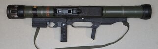

The handgrip of the Armbrust is made from black plastic and contains the piezo electric fuze with the trigger to ignite the propelling charge, the fold out shoulder support, and the fold out hand grip. When folded in, the hand grip forms the cover and safety for the trigger. On the side of the pipe, a polyurethane cushion is placed (picture 01), housing the reflex sight. The reflex sight is protected by a rip away cover that keeps the sight moist free.

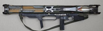

The HE-FRAG version of the Armbrust suffered from the same disadvantages, although silent and difficult to spot the firing point, modern HE-FRAG automatic grenade launchers and underslung grenade throwers have the same result without having to carry a heavy single shot disposable weapon into the battlefield.

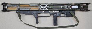

The HEAT projectile (pictures 02 and 10)
It has a main charge 170 grams of RDX 95/5, the copper cone 55 weighs grams, complete weight of the projectile is 980 grams.
Arming of the projectile is generally the same as the HE-FRAG projectile as far as the breaking rod with pin, allowing the fuze to arm only after being releasesd from the forward piston. Regretfully only a dummy fuze is placed in this practice version of the HEAT projectile. A picture of the fuze is taken from a perspex factory model of the Armbrust (picture 14).

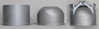

09 - Shock absorber and brake pipe before and after deformation.jpg1.4 MB · Views: 18 -
