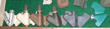

PFM-1 air, Russian air delivered dispenser mine
Took some pictures of a stick of PFM practice mines and a KPOM-2 cassette with four sticks of mines
