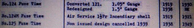

Please would someone provide some further information about this fuze.
The info below is taken from the fuze listings on this site.
It seems odd how late this fuze is keeping in mind the 124 was obsolete in 1930 and the 125 was "A non issued design cancelled in 1939" and obsolete in 1949
What does "RNADC" stand for?
Thoughts anyone?
Dave.

Thanks sgdbdr much appreciated.
PDF page 183 on the above link if anyone is interested.
Dave.
This is a strange one. None of the RNADs used a monogram incorporating RNAD. Caerwent was actually an RNPF - Royal Navy Propellant Factory. Its monogram was "CT"
TimG
Caerwent made some cadmium-plated 9mm Para dummy rounds in 1958, and RNAD C was the maker's mark they used. Must admit that I have not seen it used on anything larger, but they could have easily done a small run of work such as this for the R.N.
Roger.
Roger,
Most interesting. What source attributes It to Caerwent? It also begs the question why they were making drill round.
TimG
Tim,
The person who told me that was the late Peter Labbett when many years ago at one of the ECRA meetings at Bisley he had one for sale, which I bought on seeing the head-stamp, which was one that I did not have.
He also mertions it in his booklet "The History And Development of 9mm x 19 Parabellum Ammunition in Britain 1919-1996" on page 37, when discussing the various types of dummy U Mk.1 rounds that were made.
As he was quite the expert, and had contacts in the ammunition and British Military worlds, I suspect that what he said was correct, although I am open to being proved wrong!
Roger.
