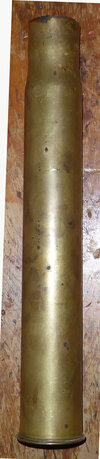

47mm (3pr) Austrian casing
I came across this today, rather doubtful that I'll find a projectile
for it. But I would like to see an image of one if anyone has one.

4,7cm SFK L/44 Skoda; Is this a licence built Hotchkiss ? as the casing is rather universal.
Thank you for the projectile images.
case longer than hotchkiss, 47x385 vs 47x377.
this gun was always referred to Skoda in Austro Hungarian docs.

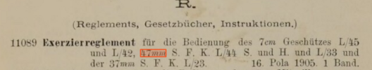

Hi
Service : k.u.k.Marina :
47mm S.F.K. L/33 H (Hotchkiss)
47mm S.F.K. L/44 H (Hotchkiss)
47mm S.F.K. L/44 S (Skoda )
Diferent guns and diferent ammo.
Marine manual : 47mm L/33 H, L/44 S + 37mm L/23 S , since 1902.
Altough the Hotchkiss gun was in service I never found AH made case (47x377).
It seems Skoda and Hotchkiss had cooperation for development of naval guns dropped at the end of XIX sec.
Could modifying the case circumvent the royalties payment?
The last known 4,7cm used by AH navy was 47x401 Nordenfeldt L/50, listed as 4,7cm Engl. Marine Kn. in 1918 army manual.
regards

The result is also in the regulations 47mm SFK L/44 H 47mm SFK L/44 S here is a preview of the case :) why did they decide to operate both systems simultaneously ... that is the question :)
