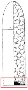

Hello Mark,
Like the other 2 Gentleman said it's German 77 mm Canister WW1

Thank you very much everyone. That settles it. The round I have fits perfectly with those descriptions and the drawings supplied by LEAFLET (even down to the position of the rivets). Thanks, Mark.
