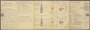

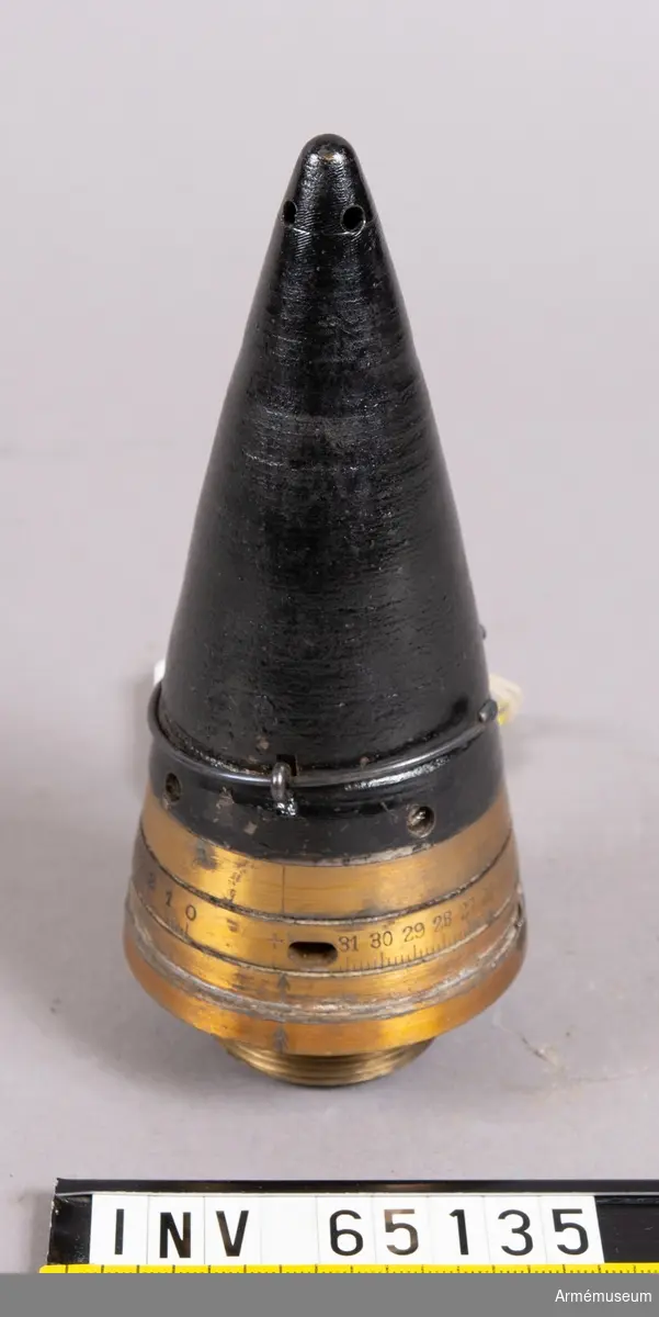

If we were talking about the Czechoslovak version: 8cm Time Grenade vz.19, then in the Czechoslovak regulations it has this design.
The rim is thin copper... You can also see that the paint was not military for the Czechoslovak Army.
If we go further into history, there is a old-type of the 8cm Granat M.18 type, it looked like this

Or laboratory drawings Skoda (war product)
In my opinion, it is an export version or a version that Austria/ Böhler (or another country) had after 1919.
