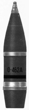

Hi,
Looking to restore a relic condition 122mm Russian HE shell, the fuse is in a bad way so thinking of just replacing with something less corroded.
Does anyone know the fuse type that I should be looking for? (I have a V-429 and the fuse in the photos below is shorter than the V-429). The top section as seen removed below is 14.24mm tall - excluding top and bottom threads.
Many thanks

Hi FSCA-UK
Can you provide a photo of the entire projectile with the adapter screwed on and if possible, maybe measure the height of the entire projectile and the height of the separate adapter for the fuse?
I would appreciate that :)

It is a KTM-2 and the shell is most likely a 122mm D-462 (53-Д-462) smoke shell. It must have a long burster tube screwed into the fuze well.

We have a sample - original photo - I would say that it does not fit..when I compare it with the OF-462A version or the D-462 version.Namely, the D-462 version has an internal case for the charge and it would be visible and it is not there.The OF-462A version - here it contradicts the height of the case ...(estimate) until we have a photo and measurements..
That ammo sample case is definitely inferior.
Interesting Russian sources state that until 1935 there was also a version of the ОФ-462Л (OF-462L) available, about which I know absolutely nothing...By the way, the sources state that the previously produced O-462А shell was later re-designated OF-462A.
I'm waiting for colleague to measure it and take a picture - for now I'm just guessing..

Right, first of all we are looking at a two-part (three if we include the booster housing) KTM-series fuze, which is attached to the nose fuze well of a projectile. The two visible components in nose area of the projectile are the two parts of the fuze. They are not the fuze and the fuze adapter. A fuze adapter may be present, but this is not visible in the imagery posted by FCSA-UK so far (as of 22:05'ish on the 18th of September 2025). Two comparison images using the KTM-1 fuze as an example are below.
If the projectile is 122 mm, the KTM-series fuze normally used is the KTM-2, and this is used with the 122 mm 53-D-462 smoke projectile. The KTM-2 has an externally-threaded lower area, which uses ‘SP 26.56×16 TPI’ threading. Diagrams of the KTM-2 below.
Official Russian reference materials also states the KTM-1 was temporally used on high explosive fragmentation projectiles fired from the 122 mm 1910/30 howitzer during the World War Two. To use the KTM-1, or the KTMZ-1, this would require a projectile with a fuze well with M36×2.5 (more correctly SP 36.14×10 TPI) internal threading. This is the same thread type as the RGM, D-1, V-429, etc., series of fuzes. As such the same nose well thread type as most Russian 122 mm high explosive fragmentation projectiles.
Ultimately once the lower part of the fuze is removed and its threads shown, along with a photo of the complete projectile, we will be able to say with more accuracy what fuze it is, and what projectile it is screwed into.
For further reference diagrams of the the KTMZ-1 and KTM-3 fuzes are below.
