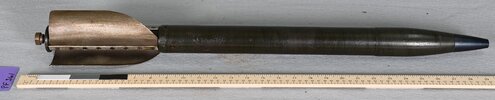

German projectiles drive me nuts. Not enough quality references, and so many variations - Most of these I know the basics, but need model numbers/designations.

They look sort of familiar, MTM Collection?
AMS 2868: 8,8 cm Lg. Patr. L4,4.
AMS 2864: difficult to say 100%, but the shell looks like a 8,8 cm Br. Schr. Flak.
AMS 2852: 10 cm Pgzr. Flak or Pzgr. Rot.
AMS 2846: 10,5 cm Üb. Spgr. L/4,1 mit Kopfladung
AMS 2838: see AMS 2852
AMS 2834: 10,5 cm Lg. L/4 or L/4,2
AMS 2814: 8,8 cm Üb.Gr. L/2,8
Ams 2798: 7,5 cm Üb. Spgr. L/4,7 Üb. S.
AMS 1553: 5 cm Rö.Gr. 42 Ausführung A.
Best regards,
Zünder.
AMS 2964: looks a lot like a french 155 mm Mle 1887-1894
Ams 2957: again French, I think 155 Mle 1915-B Gp. Not sure if a S/30 coould be fitted to this shell.
Ams 2949: 15 cm Spgr. L/4,5 Kz (m. Hb.)
Ams 2917: 12,7 cm Lg. L/4,5
Ams 2900: 17 cm Lg. L/3,7
You are almost there, but I’m missing a few more Illum. shells, 20,3 cm Lg L/4,5 and 7,5 cm Lg. L/4,5 for instance.
Best regards,
Zünder.
