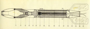

Ok, it sounds silly, having in mind how common the rocket was, but it appears to be a surprisingly tricky question - what are the actual dimensions of the 8,8 cm RPzBGr 4322 rocket?
The rocket is most commonly described in books and EOD manuals as being 66 cm (sometimes 65 cm) long. But I've seen two original German drawings from 1943, where the length of the complete rocket is given as 702.2 mm and 703.2 mm (or 662.5 mm and 663.5 mm without the fuse respectively, in the latter case the body without fuse and fins is 658.5 mm long). When I compared these drawings with photos of the rockets, the real rockets seemed to be shorter than in these drawings, though.
Then, what is the warhead assembly length? Various German plans give its length as 307.5 mm or 308.5 mm without the fuse. But according to an Allied report on the Panzerblitz 2 rocket, where the warhead is precisely measured, it was 313 mm long (the difference is in the rear conical part).
So what is in reality? Wouldn't someone like just to measure an actual rocket, please?
Thank you, I know the drawing - the problem is. when you compare it with photos of real rockets, they are stubbier than in this drawing. Hence my question.
One of my comparisons with photos - drawing 702.2 mm long (upper), and drawing 660 mm long (lower). The real rockets seem to be 660 long.

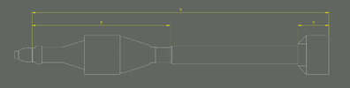

Hello Alan,
Thank you very much, I'd be happy with the three dimensions marked in the attached drawing below (the tail section length being the least important).

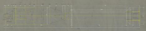

According to invenio RH 8/4931 page 18 it is L-698,2 mm
AkonView attachment 208011
Thank you, I know the drawing too. The problem is, the real 8,8 cm RPzBGr 4322 is neither 702,2, nor 698,2 mm long (please note, the 698,2 mm in this drawing refers to the body of the rocket alone, with the drum stabilizer protruding another 5 mm to the rear, thus making the overall length as 703,2 mm). The actual rocket appears to be somewhere around 655-660 mm long.
So it seems, there had to be a design change somewhere around the mid 1943, shortening the 8,8 cm RPzBGr 4322 by some 45-50 mm.
My whole problem begun, where I stumbled upon these very two drawings in the BA. I was very happy at first, thinking I had a final confirmation of the rocket's dimensions. But I traced a rocket according to these dimensions, compared it with photos of actual rockets and then I realized, something is wrong with these drawings.

Hi Grzesio
And what does it look like with the 8.8 cm RPzBGr 4320 version or 4329 Ex. version ?
It appears in one document source: Invenia exactly as 8.8cm .... 4320 Blind.
Regulation D 1864/2 (8,8cm 8.8 cm RPzBGr ....was approved (printed) on 4.November . 1943.
I have a drawing of this ammunition somewhere, drawn by the cz army after 1945 based on a real piece (delaboration)
There will be another production version, and it will be different for 8,8cm Pb 1 (judging by the drawing) used part of that warhead....
8,8cm Pb 1:
I've once seen an incomplete Panzerschreck rocket, with a regular engine and fins, but there was only a long tube in place of a warhead - I suspect, it could be remains of the 4320 Bl. or 4329 Ex with outer warhead elements missing.
By the way, it's interesting that this 702.3 mm long rocket from Invenio was originally designated as the RPzBGr 8250 in the drawing of August 1943, later corrected to 4322. In the April 1943 drawing it's called P 88 n.A. On the other hand, early designation of the Panzerschreck was RPzB 6030.
I think, the Pb 1 and Pb 2 warhead was just a regular 8,8 cm Geschosskopf Ausf. B (the same as of the 4312, 4322 and 4992), just with an additional ogival fairing at the nose and conical or cylindrical fairing at the rear, matching it with the engine diameter of 81 or 55 mm, depending on the rocket. I've once made such comparisons of Pb 2 shapes (depending on the fairings installed) and different AT rockets.

Morn Grzesio,
Here are the measurements, as best I can do.
Bear in mind that the motor unit is not quite screwed home.
Overall length 614mm, less perhaps 3mm for discrepancy noted above, so 611mm, and probably 610 if the motor unit screws in fully.
Length of warhead 305mm and length of tail unit, end of drum to joint 69mm. Be aware that the end of the drum is not precisely flat, as the flaps that secure the drum to the vanes have slight inequalities.
Hope that helps, don't hesitate to come back if I can assist further.

Thank you VERY much!!!
So I think, it's all clear now - it comes out, the complete 8,8 cm RPzBGr 4322 (with a 40 mm fuze) is approx. 650 mm long, so matches the lowest value I encountered in publications.
I also corrected the drawing from August 1943 (702.2 mm OAL), changing its combustion chamber length to 261 mm (as measured by Irod7) and received the length of 612 mm without the fuze or 652 mm with the fuze (having the warhead 307.5 mm long). So everything is beautifully corroborated, I think. :D
