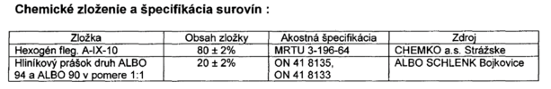

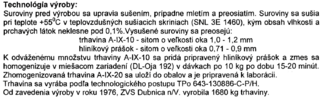

Nazdar AKON,
čo sa týka chemického zloženia trhaviny A-IX-20 čs. výroby, vždy som si myslel, že je to percentuálny pomer flegmatizovaného RDX (A-IX-10)/AL - (80/20). Keď sa pozrieš na hore uvedenú technickú špecifikáciu, nikde nevidíš písmeno "O". Všade uvidíš evidentne číslicu "0". Tým nechcem tvrdiť, že tam ten OXIZÍN nie je ale indexy trhavín A-IX-10 a A-IX-20 hovoria jasnou rečou.
Hi AKON,
regarding the chemical composition of the A-IX-20 explosive of Czechoslovak production, I always thought that it was the percentage ratio of phlegmatized RDX (A-IX-10)/AL - (80/20). When you look at the technical specification above, you don't see the letter "O" anywhere. You will obviously see the number "0" everywhere. I don't mean to say that the OXIZINE is not there, but the indices of the A-IX-10 and A-IX-20 explosives speak for themselves.
