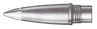

As to the MK 61 MOD 0 practice warhead, in this case the 'AI' models have been trained on data that included the warhead in question. An example would be a publication such as the 1970 edition of NAVAIR-11-85-5, which covers airborne rockets. An excerpt (cropped screen shot) from page 4-15 of NAVAIR-11-85-5 is below.
There's no image of the MK 61 MOD 0 practice warhead in that publication I'm sorry to say, but I've added an image of the fragmentation warhead that it emulates for reference. In this case it's the MK 1 MOD 5 fragmentation warhead, which is not a one-part construction like the MK 61 MOD 0 practice warhead.
NAVAIR-11-85-5 - Airborne Rockets - Mk 1 Mod 5 Fragmentation Warhead (1970).png
Agreed on AI reference sourcing. Thank you for the solid reference. 1970 edition of NAVAIR-11-85-5. I found a place for it in my War room.
