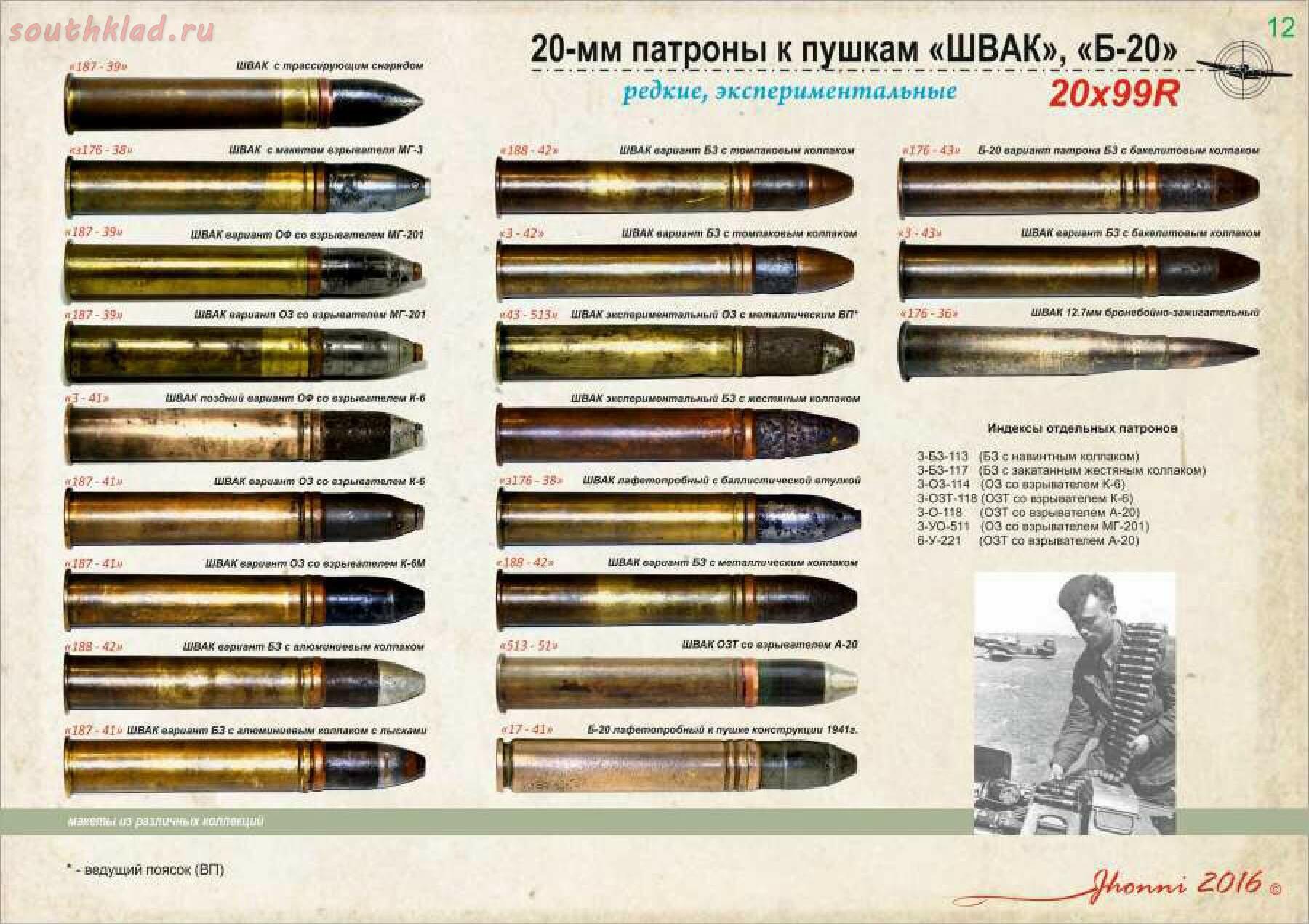

As far as I know this short russian 20mm is 54mm long.
Not exactly the same (different tracer element) but no other idea.
HI MINENAZ16
I continued your correct idea a bit...
This is one of the development versions of the 20mm T cartridge.
Hi Burney Davis According to the data, the bullet should have 8 right- grooves. Is this true on your specimen?
-In the archive fund: Air Force Command (Fund 29), inventory no. 40 . I found a record of 5 sheets for the 20mm T cartridge. Or rather, about its tests at the firing range. Dated to 1939.

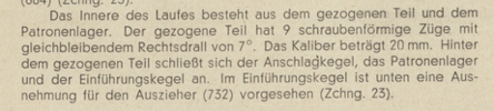

It has 9 grooves/lands and is right hand twist so probably not from that weapon.
Hi BD
This brings me to the next point :) that I don't know anything. The only thing that could change this is to read all the correspondence on the 20mm Svak project, whether it was always 8 grooves or was there another variant.... The truth is that there were plenty of 20mm weapons (Berezin ... ), including prototypes. I'll see if I can find 9 grooves in the Russian material...

For now, there are two parameters that exclude its use in 2cm Svak. By the way, Svak was also produced outside of Russia and who knows in what modifications? :) I was interested in the detail of the groove on the bullet for crimping the cartridge.... I found one on a Czechoslovak rifle..here is an example:

9 lands/ grooves for example, it has a German 20mm MG-FF, i.e. it also shows the groove for crimping the cartridge on Oerlikon...

As for HS-404, it meets the 9-groove parameter, so it advances to the semifinals (it's possible).
That front ogival is quite Hispano :)
