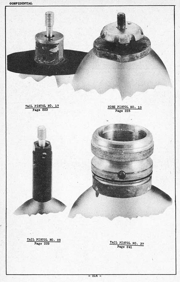

The site https://stephentaylorhistorian.com/2018/03/03/british-bombs-fuzes-pistols-and-detonators-of-ww2/ has simply uploaded copies of pages from the USNBD manuald - Always look for original sources not for web sites that upload material taken from other sources without mentioning their origin - the origin may be a good one as in the present case, but may be a totally fantasy one - I'll just mention the iconic case case of the Stankovic so-called "106kg" bomb on the web as an example of such fantasy.
here for insance 2 pages from the original USNBD - you can see at once the source of this website
The original USNBD manual can be downloaded from the excellent BulletPicker site:
